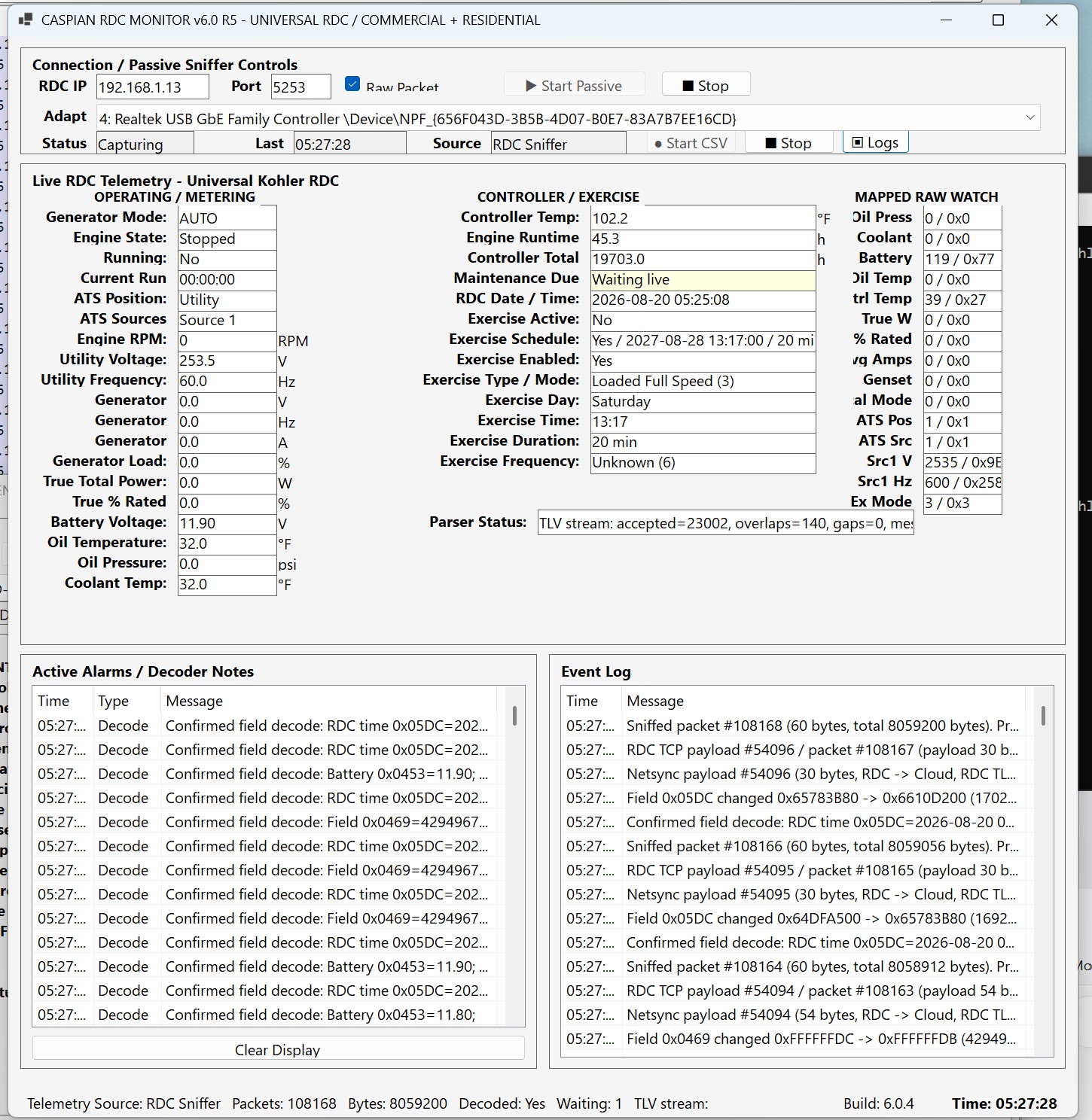

Since you offered to help I am ready to share my work so far on the monitor only version, Here is a screen shot of the DEV RDC UI. Not the final UI but I use this to see what works and what does not.
This is monitoring the 38KW RDC on my desk so some values are not accurate since it is not connected to a generator, It is connected to Kohler's ONCue server at devices.kohler (rehlko) .com
If you are still with me on this I will send you a protected copy of the runtime, just understand I am not releasing this to the public domain so it must not be shared on any website including github.

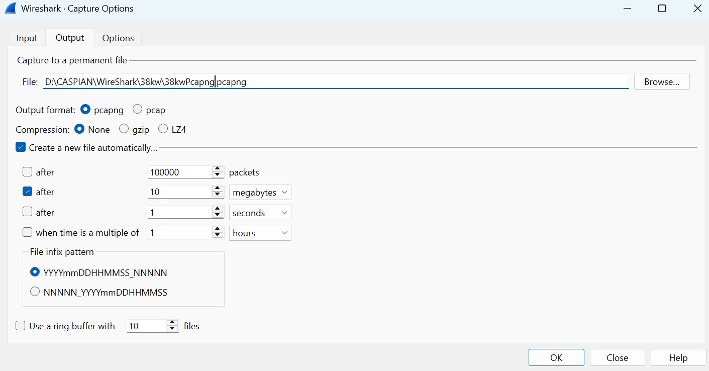

I would still like some .pcapng files from your wireshark captures and I would like you to configure the output to a file as shown in the other image here. Choose any file name and path you like. [/img]
I would like you to leave it capturing for 12 hours, zip all the .pcapng files and upload them here if not too big, otherwise I will give you an upload link to one of my Synology NAS boxes

I have been putting in more time on this the last few days when I can.
